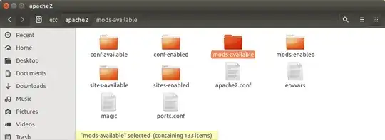

Nautilus Shortcuts
You can use Alt-Left and Alt-Right to move through your location history.
Alt-Left has the same functionality as Backspace.
Similarly, Alt-Up and Alt-Down move your location up and down the directory branch visible on the address bar.
Example: enter image description here
In the example above Alt-Up would move you to /etc/.
Likewise, Alt-Down would move you to /etc/apache2/mods-available/.
