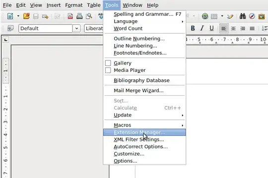

  2. In LibreOffice, select Tools → Extension Manager from the menu bar.
    Tools > Extension Manager...

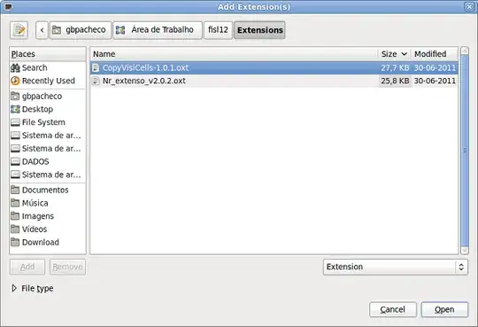

  3. In the Extension Manager dialog (Figure 2), click Add. Using the Extension Manager
  4. A file browser window opens. In Add Extension(s) dialog, you can find the extension's files in your system folders. The extension's files have OXT file extension. Add Extension(s) dialog
  5. Find and select the extension you want to install and click Open.

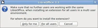

  7. After, you are asked whether to install the extension only for your user or for all users.
    • If you choose Only for me option, the extension is installed only for your user (the extension will be stored in your user profile and other users will not have access to it).
    • If you choose For all users, you must have system administrator rights. In this case, the extension is installed in LibreOffice system folder and will be available for all users.
    • In general, choose Only to me, that doesn't require administration rights on the operating system.
      Installation options: Only for me or For all users

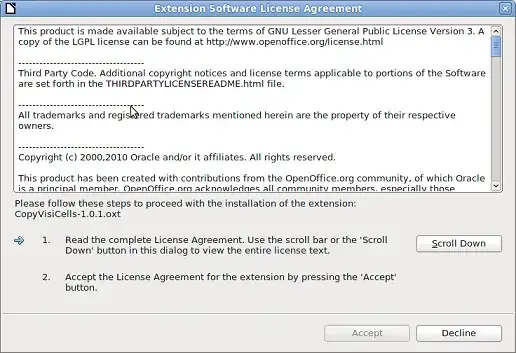

  8. After, you may be asked to accept a license agreement. Use Scroll Down button to verify the license
  9. Use Scroll Down button to read the license agreement. At the end of license text, the Accept button will be enabled.
  10. Click Accept to proceed the installation.

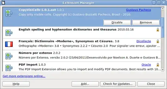

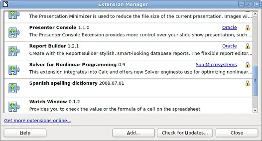

  11. When the installation is complete, the extension is listed in the Extension Manager dialog. Extension Manager dialog (again), now contained the installed extension
