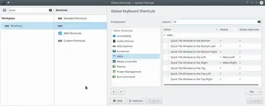

I was looking for a way to mimic the Microsoft Windows 7 window placement via keyboard including the windows (start) key.
Similar to the other answers I went:
  1. Component:
    System Settings
    -> Shortcuts
    --> Global Shortcuts
    ---> System Settings Module (KDE Plasma Version: 5.9.5)
    ---> KWin (KDE Plasma Version: 5.9.12)
  2. Action: Quick Tile Window to the {Left|Right} etc.
  3. Used key-combinations: Meta+Left, Meta+Right
here: the meta key is the name for the MS Windows start key.
