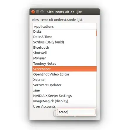

Since OP mentioned: from which I can launch a program from a list of all program installed?
Below a small script that lists all (globally) installed GUI applications. Choose one to launch it, or type a few of its characters and press Return to run the application:
To use
  • Copy the script below into an empty file, save it as list_apps.py
  • Test- run it by the command (open a terminal window, type the command and press Return):
    python3 /path/to/list_apps.py
  • If all works fine, add it to a shortcut key: choose: System Settings > "Keyboard" > "Shortcuts" > "Custom Shortcuts". Click the "+" and add the command:
    python3 /pat/to/list_apps.py
    to a shortcut key combination you like.

How it works
The script lists all .desktop files in /usr/share/applications, and checks if the line NoDisplay=true is in the file (which means it is not meant to be used as a GUI). Then it looks into the files, looks up the application name and the command to run it.
The result is listed in a zenity list, to choose from. If you pick one, the corresponding command is executed.
That's it.

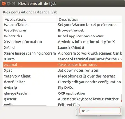

Extended version
If you also would like to have a short description on the application, As mentioned in the Comment= line of its .desktop file, use the version below:

apps.sort(key=lambda x: x[0]); apps = sum(apps, [])
displ_list = '"'+'" "'.join(apps)+'"'
try:
    chosen = subprocess.check_output([
        "/bin/bash",
        "-c",
        'zenity --list '+\
        '--column="Applications" '+\
        '--column="commands" '+\
        '--column="Description" '+\
        '--hide-column=2 --height 450 '+\
        '--width 500 '+\
        '--print-column=2 '+displ_list
        ]).decode("utf-8").split("|")[-1].strip()
    chosen = chosen[:chosen.rfind(" ")] if "%" in chosen else chosen
    subprocess.Popen([
        "/bin/bash", "-c", chosen
except subprocess.CalledProcessError:
    pass
