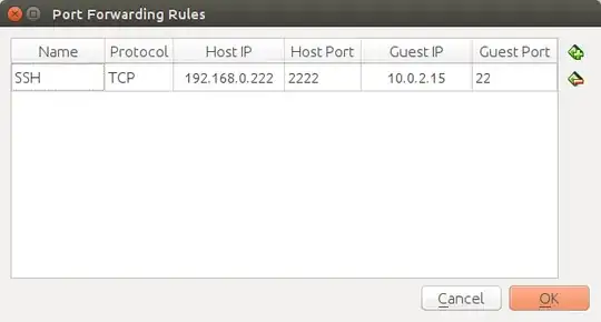

My personal setup is the following:
  1. On the router forward port 22 from remote machine to 2222 of the local machine, let's say 192.168.0.33 for example. That way you can still have ssh access to the main OS on the machine, while 2222 is for the virtual OS.
    1. On the virtual box, forward host OS 192.168.0.33 port 2222 to the guest OS's port 22. The IP of the guest can be found with the ifconfig command on the guest itself.
Now if you know your router's IP, you can ssh to your router's IP, and it will be automatically forwarded to port 2222 of your physical machine. Physical machine will give that connection to port 22 of virtual machine (provided that VM is running).
If you want to ssh from local network, use ssh -p 222 192.168.0.33
