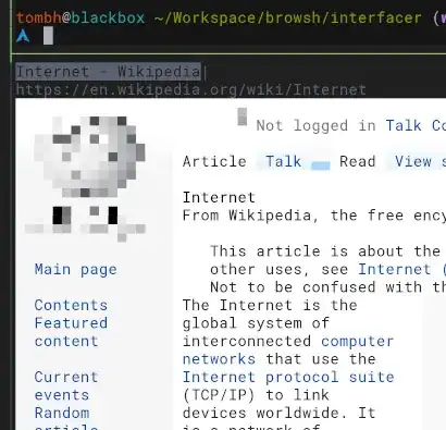

Browsh is a modern text-based browser, which runs on the terminal. According to its website, "It renders anything that a modern browser can; HTML5, CSS3, JS, video and even WebGL". It works much better than elinks. It's written in Go, so it's a single executable file, and available on most major platform (Linux, Mac, Windows, etc). (There was also a live demo, which can be accessed via SSH: $ ssh brow.sh but it is currently off-line)
screenshot

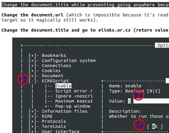

Now enable and try it, by running:
elinks ./test/ecmascript/protocol.html
Press Alt+S, O Key down () and then Space on ECMAScript, Alt+E on Enable change to 1
Alt+V to save and then OK
Now it's able to execute some Javascript.
