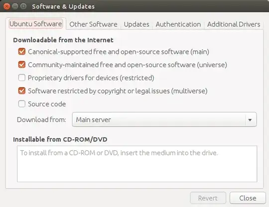

Original post In terms of /etc/apt/sources.list file those would be any software that comes from deb http://archive.ubuntu.com/ubuntu $RELEASE multiverse as well as deb http://archive.ubuntu.com/ubuntu $RELEASE restricted repository.
It's also references in the software-properties-gtk program
You can list packages in those repositories with
awk '/^Package/' /var/lib/apt/lists/archive.ubuntu.com_ubuntu_dists_$(lsb_release -c | awk '{print $2}' )_multiverse_binary-$(dpkg --print-architecture)_Packages
and
awk '/^Package/' /var/lib/apt/lists/archive.ubuntu.com_ubuntu_dists_$(lsb_release -c | awk '{print $2}' )_restricted_binary-$(dpkg --print-architecture)_Packages
