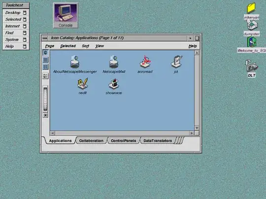

On Irix's 4Dwm, there was an ability to minimise windows into a box (contrary to the task bar used by modern window managers). I have seen this also on an old HPUX.
See the "console" square in the linked image:
Is it possible to accomplish on Ubuntu, either with a plugin or maybe some window manager other than Unity?

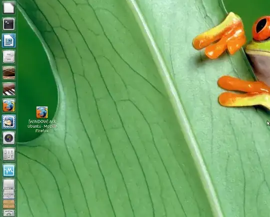

  • Pressing a key combination will "box" the window on your desktop, from a window:
    into an icon, with the application's appearance:

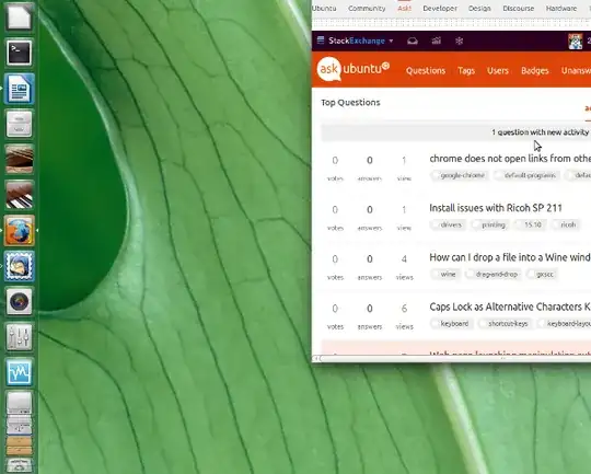

  • Double click the icon, and the window will re- appear and the icon will vanish.

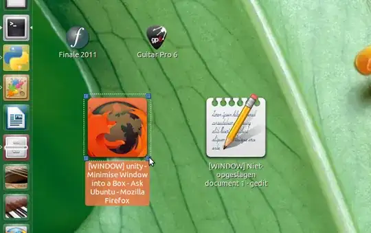

Giving the boxed-window icons a different size than the other icons
The script names the created .desktop files always boxed_1.desktop, boxed_2.desktop etc, depending on the "available" name at the moment of creation (filenames, not the displayed name).
You can resize the files (in general), by right- click > icon size. The good news is that if you remove the file and recreate it, the size is remembered. Even if you create the file again after a restart. That means that if you ever resized the boxed windows (e.g.) 1-5, they will always have the same size when you (the script) create them again!

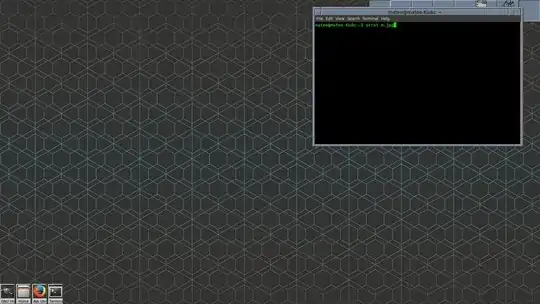

You can use fvwm to accomplish this.
  1. Install fvwm:
    sudo apt-get update
    sudo apt-get install fvwm
  2. Find a them that uses the iconify function - there are several here: http://www.jmcunx.com/fvwm_theme.html Several look like the screen-shot you show.
  3. Copy the text of the theme, then navigate to ~/.fvwm/ (show hidden files first) then create a file .fvwm2rc
  4. Open that file in a text editor (like gedit) and paste the theme text into it.
  5. Reboot the computer, and select fvwm and login.
