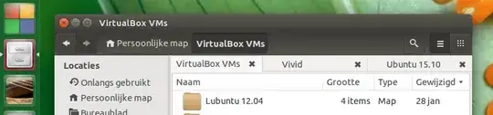

  • To open a window, do as usual: click on the nautilus launcher. Tab the window as you like:
  • To close a window definitively, close it by clicking on the window's "close" (x) box.
  • To preserve the window(s) + all its tabs:
    press the shortcut key. The window(s) will vanish (seemingly close).
  • Next time when you click the launcher, the nautilus window(s) will appear exactly like the last time, even the window position(s) will be preserved.
