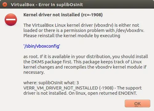

When starting a VirtualBox VM, I get:
VirtualBox - Error in suplibOsInit
Running sudo /sbin/vboxconfig does not fix the problem.
How to fix that?
