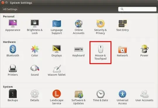

Settings only shows what is marked in red:
Settings view

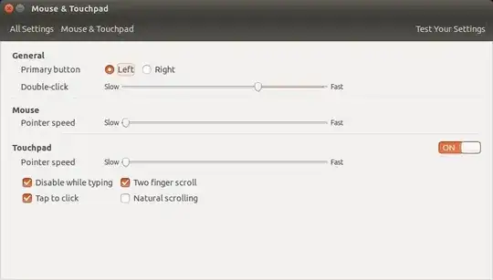

And that does not show any widgets that allow me to control TrackPoint behavior, which is what led me to believe something was missing, and therefore, that I needed to hunt down and install some special packages:
Mouse and Touchpad view
