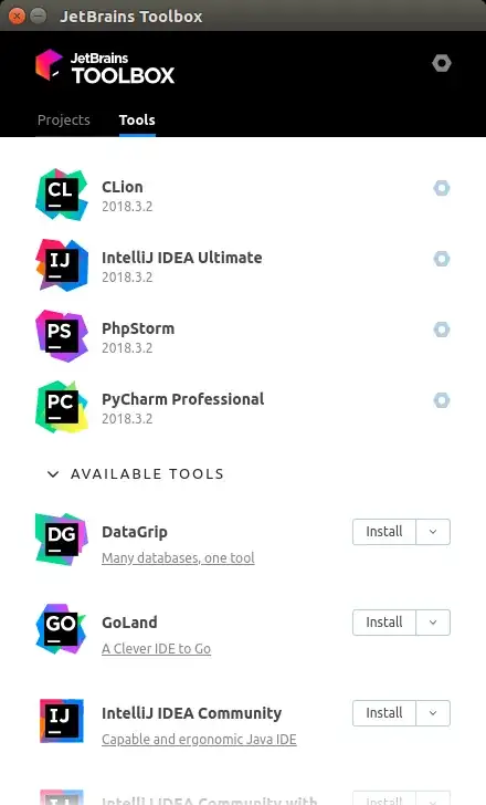

Toolbox screenshot
It will list your installed IDEs, and show all other available products below that. Just click the Install button next to the PyCharm edition you want (free Community or paid Professional) and it will do everything for you in background.
