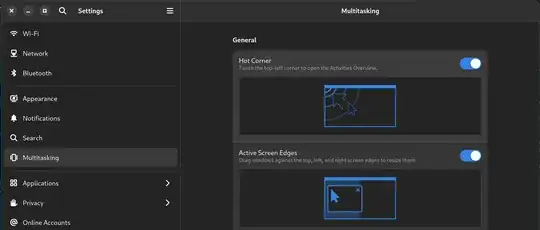

Recent GNOME Versions
Recent GNOME versions don't require gnome-tweak-tool to change this.
You can find a switch for Activities Hot Corner in GNOME Settings application under Multitasking category.
Multitasking Category in Gnome Settings application

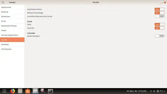

mmai

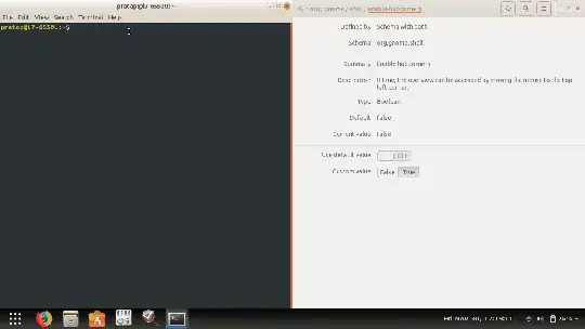

Command-line way
If you are looking for the gsettings command for this "Activities Overview Hot Corner" option in GNOME Tweaks:
then, the key is gsettings set org.gnome.shell enable-hot-corners true|false
example:
gsettings set org.gnome.shell enable-hot-corners false

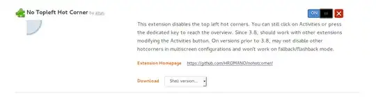

Why not install the gnome-shell-extension directly? It's much easier, and works for gnome in every linux distribution.
https://extensions.gnome.org/extension/118/no-topleft-hot-corner/
Update for gnome>3.36:
This extension is not needed anymore as it is now supported by the shell itself. You can switch off the hotcorner with a gsettings or using gnome-tweak tool.

If you have already enabled the infrastructure to use Gnome-Extensions, you can simply go to the extensions webpage, search for "hot corners" and click the switch to turn it on.
Here is an example of the url:
Here is a screenshot of the button to switch on:
Screenshot of extendsions.gnome.org link

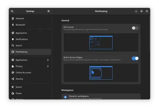

Funny how an ancient post pops up and does not have a recent answer, non of the solutions work for recent versions of Gnome Shell.
For Fedora Worstation 36 with Gnome Shell 42.4, this can be found in settings under multitasking, see screenshot (Active Screen Edges can be switched there too):
enter image description here update : still valid on Fedora 39 and Gnome 45.5 ! Assuming it's the same for the in between version of Fedora 37 and 38.
I assume Gnome 43 will have this too.

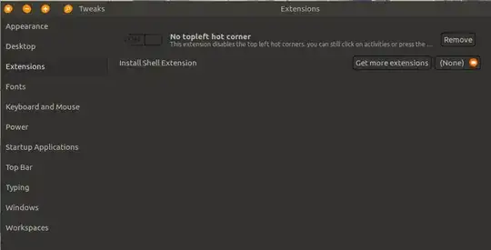

Install Gnome Tweak Tools with:
sudo apt-get install gnome-tweak-tool.
Once installed open the tweak tool app and go to the option marked extensions on the left:
Next go to the following location HERE and download the "No Top Left Corner" extension by Azuri. This is an extension to work with Gnome-Tweak Tool. When you download, you will be asked for the gnome shell version you are using. You can check it with the following command:
gnome-shell --version.
Once downloaded, go back to the Tweak Tool and at the end of the extensions list is a File button to add more extensions. Click it, and then select the zip file containing the shell extension downloaded.
That's it. It may require a restart. For me it asked for a restart, but even before that the hot corner was off.
