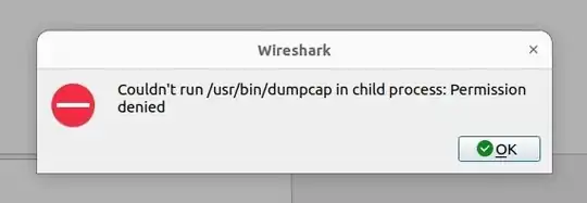

  4. Potential errors when trying to capture packets:
    Couldn't run /usr/bin/dumpcap in child process: Permission denied
    Or:
    Solution:
    Either of those things above means that you need root permissions to capture packets. You can do this:
    1. [brute-force run it as root] Close Wireshark, and then run it as root:
      sudo wireshark
    2. OR: [recommended] Close Wireshark, and then configure it to not require root:
      # 1. run this, and be sure to choose "Yes" this time
      sudo dpkg-reconfigure wireshark-common
      2. Add your username to the wireshark group:
      sudo usermod -a -G wireshark "$USER"
      Now log out of Ubuntu (or restart your computer), and log back in, to register your username in this new group.
