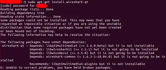

ERRORS: enter image description here
EDIT 1: I tried to install wireshark-qt but I get the same type of error... enter image description here
EDIT 2: I tried solutions from this post, but none seem to help my case.

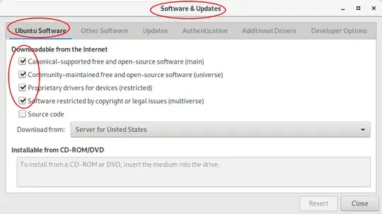

Remove or disable the PPA.
Then checkmark the following Ubuntu repositories... and reload the databases on quit...
Then install Wireshark from Synaptic, the Software Center, or...
In terminal...
