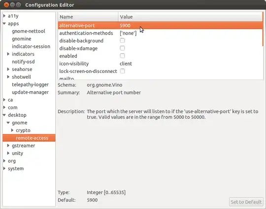

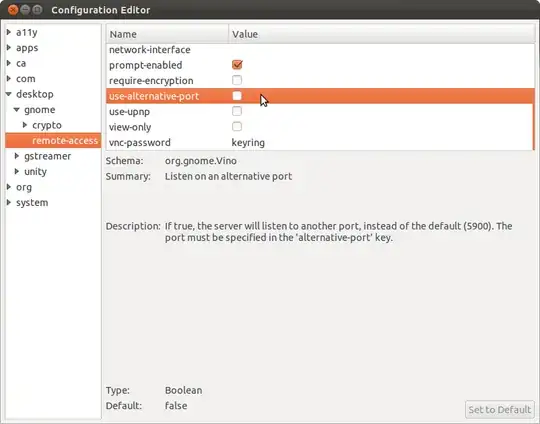

Install dconf-editor
sudo apt-get install dconf-tools
Press alt+f2 and type dconf-editor
Navigate to desktop>gnome>remote access and change your port there, don't forget to tick the use-alternative-port option so that vino uses the one you set:

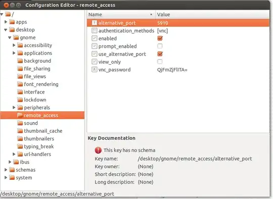

On Ubuntu 14.10, gconf-editor was required. dconf-editor set a value, but it was not used, and displayed as 0 (5900) in gconf-editor.
sudo apt-get install gconf-editor
gconf-editor
