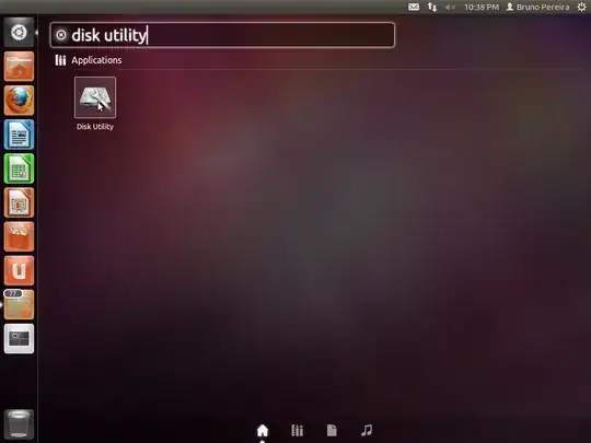

Look for Disk Utility on you dash (as an option press Alt+F2 and type palimpsest)

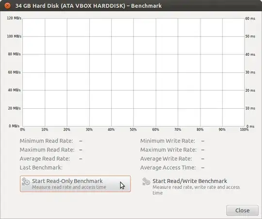

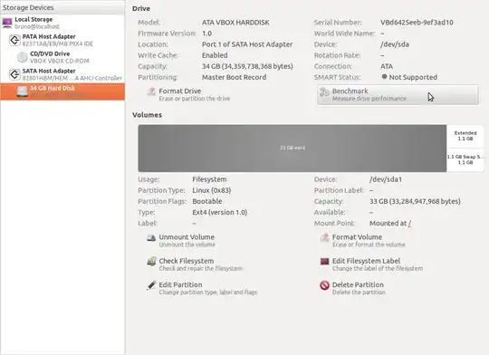

Click on the disk you want information from, to test it click on Benchmark
To start benchmark, select Read only or Read/Write benchmark

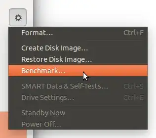

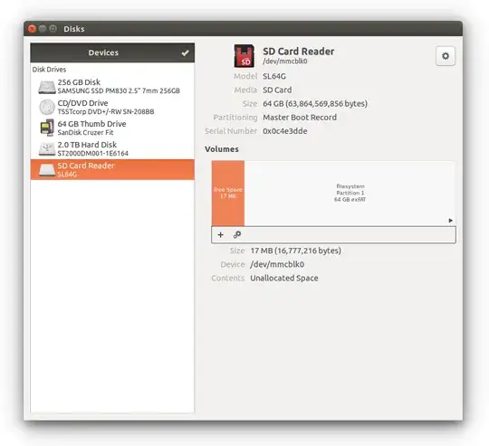

Usage

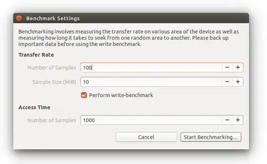

Select the disk you wish to test. enter image description here Find the menu in the top right and select Benchmark...

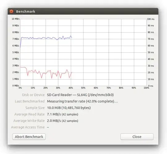

A window will appear. Click Start Benchmark... to see: enter image description here
I left the defaults and clicked Start Benchmarking.... It will run for a while, building the chart over time. enter image description here You can see that my new SD card's read rate is around 7 MB/s, while the write rate is only slightly over 2 MB/s.
The model shown here is a SanDisk Ultra SDXC with an advertised speed of up to 30 MB/s. As you can see, the transfer rate is not as advertised.
