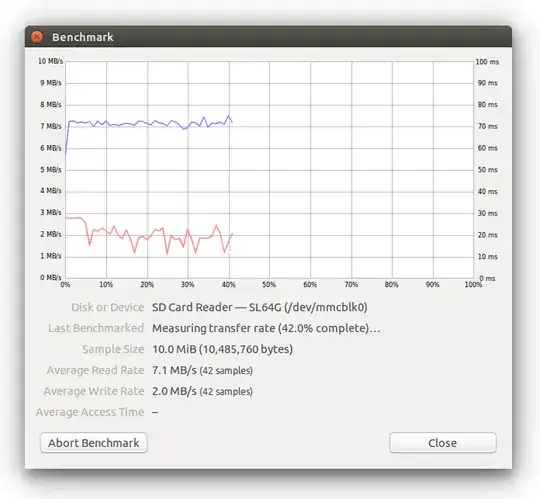

I then ran a benchmark using gnome-disks:
As you can see, the average read speed of 7.1 MB/s which is a long way from 30 MB/s. That's 4.2 times slower (23%).

So 10 MB/s may be the throughput for a different type of load, or possibly just for a shorter time (the incomplete chart above ran for around 5 minutes before I took that screenshot.) Either way, it's still not close to 30 MB/s!
