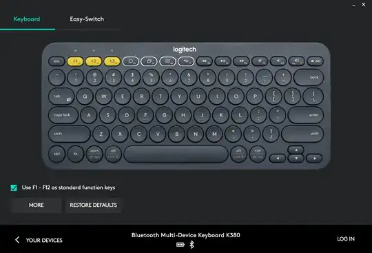

Just an update, Logitech Options software can natively support the feature, Use F1 - F12 as standard function keys. See the picture below.
CHANist
