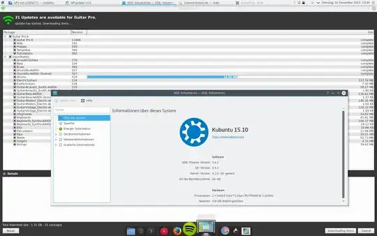

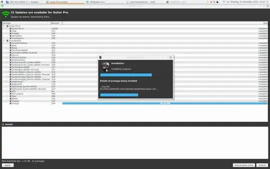

Now you are ready to rock! Here is some proof, that it worked.
updating installing
