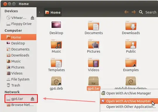

  • And open up the File Manager (Nautilus), and mount the gp6.tar as an archive by right-clicking and selecting Open in Archive Mounter; after that you'll see gp6.tar added to the bottom the left sidebar, with an eject icon next to it:

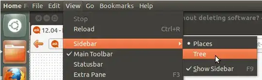

  • Go to the View Menu for File Manager, and change the Sidebar to the Tree view option instead of Places:

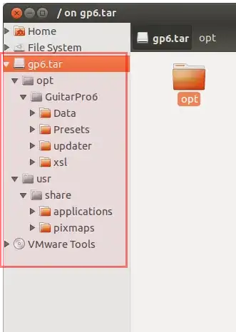

  • Now expand the gp6.tar tree in the sidebar by clicking on the triangles; repeat for each level until you can see the folder structure of the file:
  • From the structure, we see that the program's files go into two locations: /opt and /usr/share:
    • Anything that goes into /opt is self-contained and will not affect anything else on the system.
    • We see that /usr/share only contains icons/bitmaps, which are harmless.

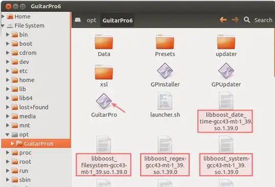

  • Open up the /opt/GuitarPro6 folder in the File Manager:
    • We see that the executable is called GuitarPro (with the diamond-"gears" icon), and also that a lot of lib-xxxx files are included in the folder.
    • This is normal for binary-only programs; they try to include the versions of the specific libraries they need, since those may not be available from the repositories of a specific distribution.
  • Along with these included libraries and the ia32-libs package, most 32-bit dependencies should have been installed. Instead of blindly installing the dependencies we saw in the deb file info via apt-get--which can cause problems-- let's figure out if we're actually missing anything.

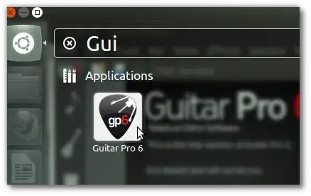

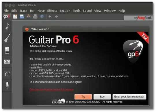

  • Exit the terminal and go back to the /opt/GuitarPro6 folder in the File Manager. Double-click GuitarPro and...
  • Clean-up the Download folder by deleting the tar file from the File Manager.
5. The launcher shortcut has already been added
  • Because the package already contained a GuitarPro6.desktop shortcut that was extracted to /usr/share/applications, there is no need to manually create one. It's sitting there in the Launcher:
