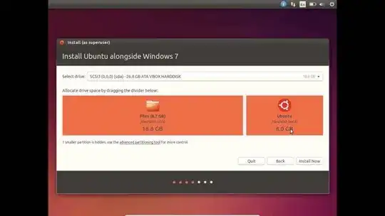

Well, installing Ubuntu alongside Windows 8(and over) is very easy. You shouldn't have gone for the "Something Else" option as "Install Ubuntu alongside Windows" was available and Ubuntu Mate 15.10 has many resolved issues. If you can, delete all those partitions you created, and restore the 600GB of space to Windows. When Windows has the 1TB back and there is no extra space for anything else but Windows, restart and boot the USB with Ubuntu installed. Choose "Install Ubuntu alongside Windows 8".
On the next screen, select how much space you want to allocate Ubuntu then follow the prompts.
More info here.
