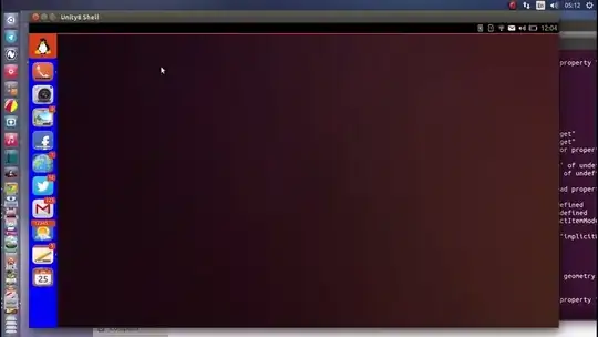

I want to create an Ubuntu 15.10-compatible Unity 7 theme which mimics the current look of Unity 8 (used in Ubuntu Touch) as closely as possible. I'm now satisfied with how all the launcher buttons look, except for the BFB. Changing the icon inside the BFB itself should not pose a problem, but as you can see below the BFB background itself is differently-shaped from the other icons:
Unity 8 shell screenshot from Google Images
The Ubuntu Wiki's guide to theming Unity 7 explains how to create the background images for the launcher icons in general, but does not give any indication for whether it is possible to theme the BFB background separately. Does anyone know if this is possible to do in Unity 7, or is the BFB internal icon the only part that can be changed?

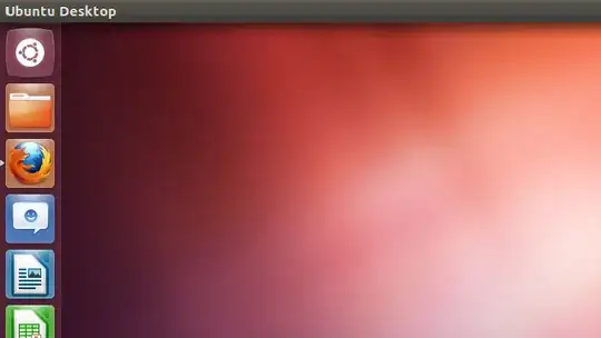

Versions prior to Unity 7, like Ubuntu 12.04LTS's Unity 5 had separate assets for Dash Button and other icon buttons. This can be seen in the image shown here:
Separate Dash and Launcher Buttons on Unity 5
Though it didn't have any theming support like Unity 7, the BFB could still be manually modded to have a different look. See this answer to know more on modding Unity 5's BFB: Change Dash Button on Ubuntu 12.04LTS
