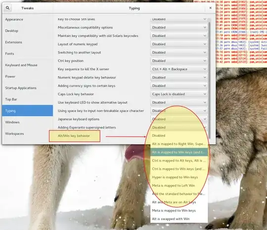

Xmodmap will not work; it has been obsoleted.
In gnome, I think that you can do what you want with gnome-tweak-tool (I think there is an equivalent unity-tweak-tool or similar for Unity):
g-t-t typing
...should be one of those options. To read the complete definition, due to a bug, you need to dig into the files /usr/share/X11/xkb/rules/*.lst --- i think the one interesting to you would be
altwin:ctrl_alt_win Ctrl is mapped to Alt keys, Alt is mapped to Win keys
from xorg.lst, which I suppose is the fourth one in the list.
I cannot check it, but maybe
setxkbmap -option altwin:ctrl_alt_win
can work... from the usually useful arch page.
(and yes, xkb or at least its current status is a PITA. Complex, undocumented system which I am sure noone knows in detail. See the first quote here. ).
