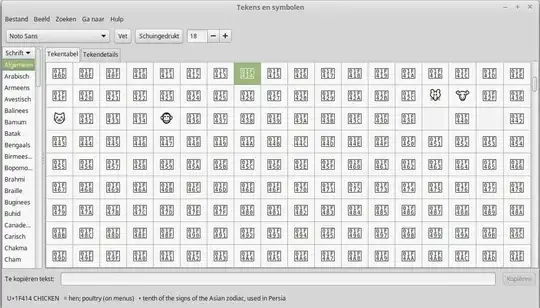

I tried to view the characters on my computer (See signs and symbols). Enter the Unicode-code in the search-window. It looks that the symbols mentioned are not rendered yet (These characters are in the Supplementary Multilingual Plane). See also http://www.ltg.ed.ac.uk/~richard/unicode-sample-3-2.html.
File a bug in https://bugzilla.gnome.org/enter_bug.cgi?product=gucharmapenter image description here
