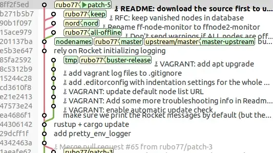

It seems like the default font "Ubuntu" is missing the character "⚷" Which makes smartgit to fallback to the next font "Noto" which has a strange line-height, so all commit lines with that kind of "key" icon are half a line off to the bottom:
We found out that the Noto font is used as replacement for the Ubuntu font with

The problem comes from 26b7 being almost twice as high as regular text:
81x17 = GC.stringExtent("X test string")
80x31 = GC.stringExtent("⚷ test string")
The entire font 'Noto Sans Symbols' is bigger then its regular counterpart 'Noto Sans'.
