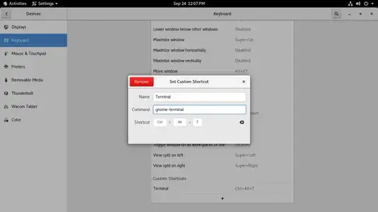

For CentOS 8 - Stream I have made size as 95x65 by brute force.
Also, menu hidden with Right-click preferences. And untick the default menu option.
Finally a shortcut added Ctrl + Shift + T
From Settings Shortcut for CentOS 8 Stream Terminal
For adding this shortcut - follow above steps, which is common in CentOS. But implemntation is added in this answer.
Terminal shortcut settings
