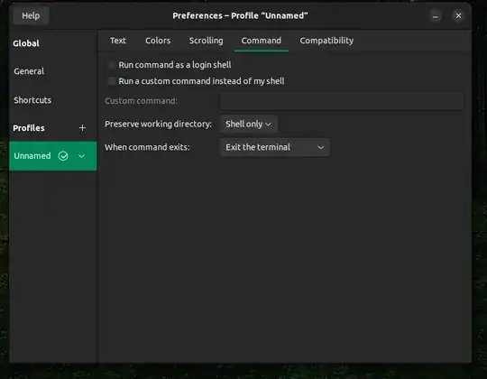

Basically, I want that every time I open the terminal, it does on fullscreen. I tried writing a command on the profile, but I got a weird glitch.

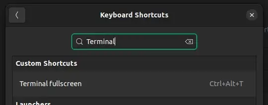

This is my solution. It may not be the one that I was looking for, but it works.

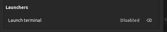

I went to settings and disabled the shortcut for opening the regular terminal.

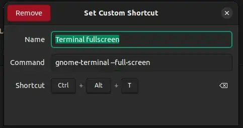

Then I created a custom shortcut with the following command: gnome-terminal --full-screen and gave it a keybinding (control + alt + t in my case)
No idea why there isn't that option on preferences, or why there isn't a space on the profiles section to write something like that. But anyway, it worked.
