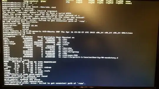

I have read the articles here about this error, such as Failed to get canonical path of /cow, but I do not understand the nature of mounting here. My hard drive is sda and the usb where ubuntu installer is located is sdb. The lsblk command also shows -sdb1 as a location with a type of part /cdrom.
I have included an image below which elucidates my configuration. Could someone please clarify how I have to mount grub given my configuration? My goal is to get Ubuntu to install and run with this 640x480 resolution so that I can update the drivers and all that once I have finally booted to the desktop. I have used the nomodeset option in the past, but it does not further the installation process. If anyone has any advice on how best to proceed from here to get to that goal, I would be exceptionally grateful.
Screenshot of terminal showing output of 'lsblk' and 'df' commands
