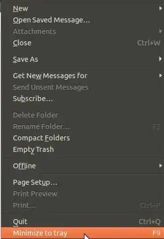

You can use the plug in called "Minimize to Tray" in Thunderbird to achieve that. Once installed Press F9 to minimize Thunderbird to the system tray. You will keep on receiving the Emails when it is minimized.
This works perfectly fine when you click the mail icon in the system tray.
I hope this will be helpful.

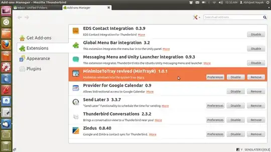

The MinimizeToTray revived add-on for Thunderbird can be configured to hide the Thunderbird icon in the Unity launcher when the close button is pressed, while leaving Thunderbird running and allowing it to be accessed through the mail indicator.
It may be installed by going to Tools --> Add-ons in Thunderbird and searching for MinimizeToTray. Once it is installed, the add-on's preferences can be configured to hide Thunderbird rather than closing or minimizing it when the close or minimize button is pressed.
Configure the add-on as follows:
  1. Once the add-on is installed, go to Tools --> Add-ons again and click the Preferences button for the MinimizeToTray (revived) add-on.
  2. In the Minimize to tray section, select Instead of closing and when minimizing option from the list.
  3. In the Unity Launcher (on the left hand side), right click on Thunderbird's entry and ensure that Keep in Launcher is not ticked.
Once this is done, clicking the close or minimize button in Thunderbird should hide it. It may be recalled using the Mail entry in the Messaging Menu. To quit the program (rather than just hiding it), use File --> Quit in Thunderbird.

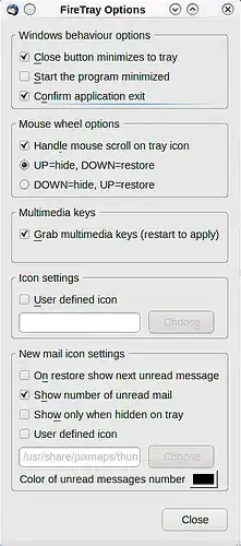

Install an Addon Called FireTray , Visit the Addon Preferences/Options/Settings and adjust accordingly. When You See that page, you'll know what to Do

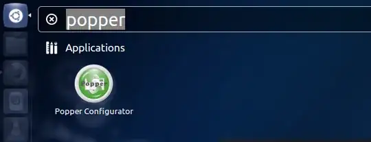

What you need is Popper. Popper reads the new emails from POP3 and IMAP email servers and notifies about the number, subject, sender and time of new emails in the indicator applet and via a notification bubble.
How to install?
Press Ctrl+Alt+T to open the terminal and run the following command:
sudo apt-get install popper
How to configure?
Press the super key (windows key) and search for popper. enter image description here

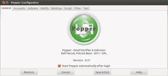

Open the Popper configurator and select "start popper automatically after login". enter image description here

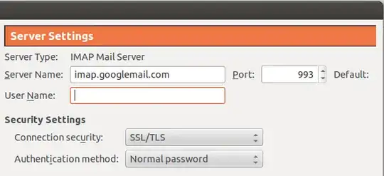

Now open the Thunderbird, and goto account settings through edit menu and select server settings under your Email Address and copy the server name and port number. enter image description here

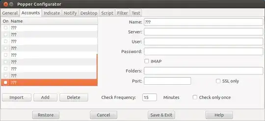

Go back to Popper configurator and select the "Account" tab enter image description here
select "add" to add new email address, Fill the fields like this:
Name: Any name of your choice
Server: Paste the server address hare that you just copied from Thunderbird
User: Your real email address
Password: Password of your email address
Port: Paste the port number hare that you copied from Thunderbird and select 'SSL only'
Select IMAP if your email provider sports IMAP (Gmail, Yahoo and GMX)
Set the check frequency (how often should popper check for new mails).

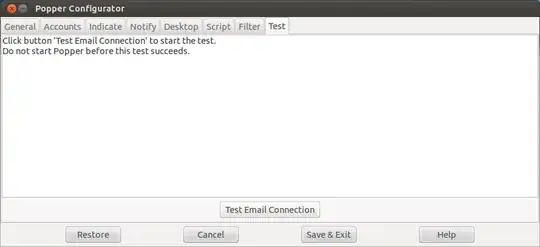

Now open the "Test" tab of Popper configurator: enter image description here
and hit "Test Email Connection", You should see a success message "OK Authentication Complete" if not than check your email address and other settings again.
Hit "Save and Exit". That's it.

  1. Install "FireTray" addon on thunderbird
  2. check "start application hidden to tray" option in FireTray preferences (Thunderbird -> Tools -> addons -> firetray -> preferences -> under tab "windows")
  3. Follow this answer to set thunderbird to startup (the command field should be filled as thunderbird or /usr/bin/thunderbird)
