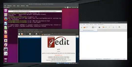

I just run the current daily-live image in VirtualBox, and it loaded X. I proceeded to install it, and the installed version also ran X:
As you can see, X11 forwarding from and to the virtual machine worked fine.
Either the integration is flawless, or Ubuntu 15.10 still uses X by default. And since the final freeze happened some weeks ago, I think we'll have to wait one more release for Mir to be default.
