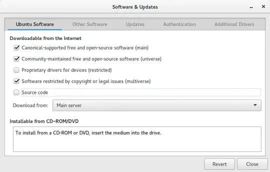

If sudo apt-add-repository main and sudo apt-add-repository multiverse doesn't work, do the following
  1. sudo mv /etc/apt/sources.list /etc/apt/sources.list.bak
  2. Open Software & Updates
  3. Activate the entries for main, universe and multiverse
  4. Click Close

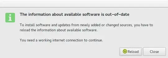

  5. Refresh the package sources via Reload
