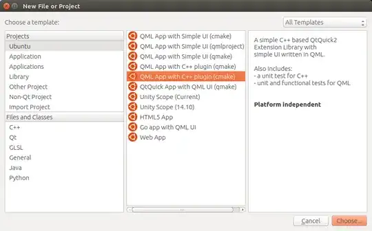

I solved this issue by creating a new project in the SDK, using the template:
And transferring my project files to this project. While not a solution to the bug, this was by my metric the quickest workaround that allowed me to get back to work.
