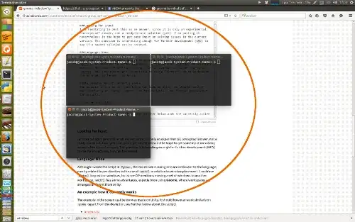

An example how it currently works, moving a group of windows
moving windows as a group
The example in the screen cast above was made on Unity. It should however work similarly on Gnome (apart from the deviation, see further below about the script).
  • In the current setup, a group of windows can be created by adding the frontmost window to the group by calling the script below with the argument: a. In the screen cast, I added the command to a (Unity) launcher, on Gnome, it could be done with a shortcut key.
  • Subsequently, if the script is called with the argument r after one of the grouped windows is moved, the script moves all windows from the group likewise, restoring the windows, relative to each other:
