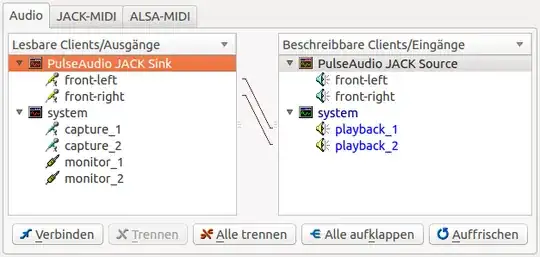

The JACK routing has only one stereo source and sink from and to PulseAudio

Extra sinks/sources can be loaded by terminal command, or using QJackCtl Option 'Execute script after Startup' commands or bash script
pactl load-module module-jack-sink client_name=pulse_sink_2 connect=yes
pactl load-module module-jack-source client_name=pulse_source_2 connect=no
without client_name option additional sinks/sources have number suffix 01, 02 etc
connect option (default is yes) using no stops connection to JACK system capture/playback
There is also a channels option (default 'channels=2')
