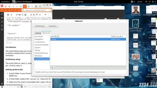

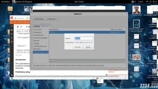

  4. Open System Settings -> Keyboard -> Shortcuts -> Custom Shortcuts.
    Create a new shortcut and give it full path of the script as command,
    for example, /home/serg/bin/resizer.sh.

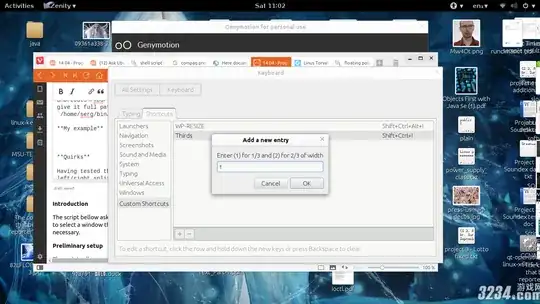

My example
I set up the shortcut first:
Then press the shortcut. The popup menu allows selection of 1/3 or 2/3 resize; I choose 1. Notice, there's no additional input, except a single 1 digit
Next I choose the free-floating browser window. It jumps to the left, now 1/3 in width, desktop height.
Same behaviour will be for the 2/3 option, excep the 2/3 window will be placed on the right side enter image description here

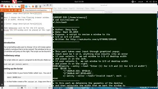

Script source
#!/bin/bash
# Author: Serg Kolo
# Date: Sept 26,2015
# Purpose: a script to resize a window to its
# 1/3 or 2/3 of width.
# Written for http://askubuntu.com/q/678608/295286
# This part takes user input through graphical popup;
# Input must be 1 or 2, anything else results into an error
# If user selects 1, we set window to 1/3 of desktop width
# and place it on the left;
# If user selects 2,  we set window to 2/3 of desktop width
# and place it on the right;
SIZE=$(zenity --entry --text "Enter (1) for 1/3 and (2) for 2/3 of width")
case  $SIZE in
    "1")NUM=0.333; XPOS=0;;
    "2")NUM=0.667;XPOS=455;;
    *) zenity --error --text="Invalid input"; exit  ;;
esac
# In this part we determine the geometry of the desktop
# and then calculate the width that we want the window to
# be set using bc, the command line calculator
# printf is used to convert floating point result to
# integer value, which is required for wmctrl
ROOT_WIDTH=$(xwininfo -root | awk '/Width/ {print $2}')
ROOT_HEIGHT=$(xwininfo -root | awk '/Height/ {print $2}' )
NEW_WIDTH=$(bc <<< $ROOT_WIDTH*$NUM)
NEW_WIDTH=$(printf "%.0f" $NEW_WIDTH)
# This is what actually does the job.
# wmctrl allows you to select the window with -r :SELECT:
# and sets that window to specific gravity,x-position,y-position,width
# height. To keep the script neutral, I've decided to set the
# height to default desktop height. User can resize the height as
# necessary by themselves
wmctrl -r :SELECT: -e 0,$XPOS,0,$NEW_WIDTH,$ROOT_HEIGHT
