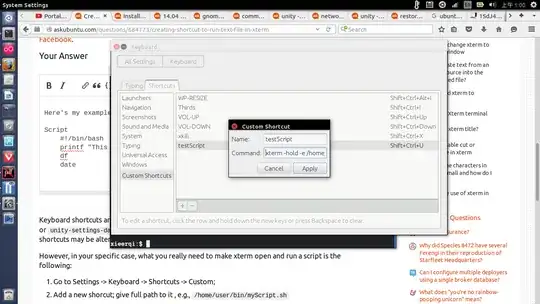

Here's my example:
Script in /home/serg/testScript.sh

Shortcut setup

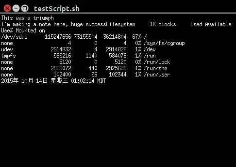

Output
