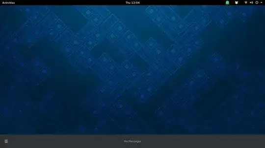

This will be by default in a bar at the bottom in 3.14 (and older versions) - you can access it by pushing the mouse at the bottom of the screen (or pressing Super+M or something), like the grey bit at the bottom of this screenshot - this also will contain notifications you get:
However, similar to the screenshot, you can move the status icons of Skype, Dropbox etc to the top bar by use of GNOME shell extensions - e.g.:
N.B with 3.16 (unavailable by default on your Ubuntu version), it has been changed so by default the the notification appear in the calendar menu, and the status icons appear in the bottom left - see here
