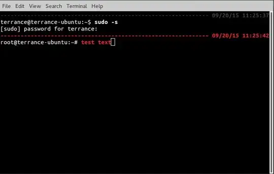

Here is one that a friend of mine and I have been working on. It gives a gray dashed line when you are a normal user, then if you are running commands as a root user, it changes to red for both the dashed line and the text.
In your .bashrc file, add the following code to the bottom of the file:
if [ -f "$HOME/.bash_ps1" ]; then
    . "$HOME/.bash_ps1"
fi
EDIT: Also, add it to the bottom of the /root/.bashrc as well. This is for if you switch to the root user by issuing the command sudo su -. (The rest of the edit is continued below code)
Then copy and paste the rest of this code to a new file called /home/<username>/.bash_ps1

EDIT (Part 2): Now create a link to the .bash_ps1 in your /root folder
sudo -s
cd /root
ln -s /home/<username>/.bash_ps1
You can change any of the above code to fit your needs. This is one that I use actually at work so that I know if I am typing in commands as a root user that could be potentially dangerous. Plus, the time stamp appears just above each line you type, making it a little easier if you scroll back to see when you typed in that command.
Hopefully this helps!
