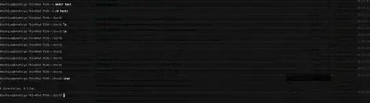

I used to have this plugin in bash which shows current time after every command I type. I added this few years back, and I don't recall how I added it. It's not listed in terminator plugins either. Now I'm moving to a new laptop and I need to install this plugin again.
Does any of you know about this? Thanks.

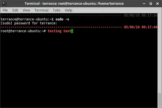

This script will add a grey dashed line with the date and time at the end of the line, then it will change to red if you run as a root user:
Add the following lines to the bottom of both /home/<username>/.bashrc and /root/.bashrc files (NOTE: /root/.bashrc has to be edited with root capabilities like sudo gedit /root/.bashrc):

After all is saved, now every time you open a new terminal window it should look like the image above. The timestamps appear after you press enter on each command you type into the terminal making it easier to scroll back and see when you ran that specific command.
Hope this helps!
