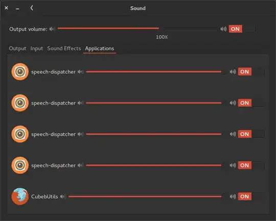

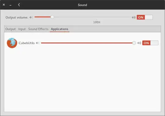

Yesterday the list looked like this:
Today the list looks like this:
So what is this speech-dispatcher that I have never seen before? And why so many of them?
Information Update:
I went into Universal Access, and it was off, I tried turning it on and then off again in there, but it makes no difference, the entries in the sound application list are still there.
When running the command ps xa | grep -P 'speech-dispatcher.*\.conf' the output is:
17906 tty2     Sl+    0:09 /usr/lib/speech-dispatcher-modules/sd_espeak /etc/speech-dispatcher/modules/espeak.conf
17911 tty2     Sl+    0:01 /usr/lib/speech-dispatcher-modules/sd_cicero /etc/speech-dispatcher/modules/cicero.conf
17915 tty2     Sl+    0:01 /usr/lib/speech-dispatcher-modules/sd_generic /etc/speech-dispatcher/modules/generic.conf
17918 tty2     Sl+    0:01 /usr/lib/speech-dispatcher-modules/sd_dummy /etc/speech-dispatcher/modules/dummy.conf
24407 pts/0    S+     0:00 grep --color=auto -P speech-dispatcher.*\.conf
OS Information:
No LSB modules are available.
Distributor ID: Ubuntu
Description:    Ubuntu 15.04
Release:    15.04
Codename:   vivid
Flavour: GNOME
GNOME Version: 3.16
