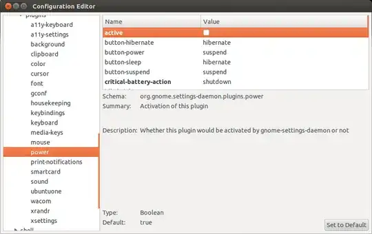

Disable the GNOME Settings Deamon's power plugin from the command line:
gsettings set org.gnome.settings-daemon.plugins.power active false
Alternatively, using dconf-editor from the dconf-tools package:

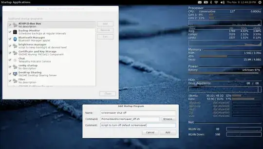

Make a plain text doc in your home folder and copy this into it.
#!/bin/bash
sleep 10 &&
xset s 0 0
xset s off
exit 0
Save the document as "screensaver_off.sh" (without quotes), then open a terminal and enter
chmod +x screensaver_off.sh
Then open up startup applications from the dash, click on the add button, name your start up application, and enter your command as:
"sh /home/$LOGNAME/screensaver_off.sh"
Then add a description and click add, reboot and your done, No more screen blanking.
You will have to do this per each user as default settings revert after logout or reboot.

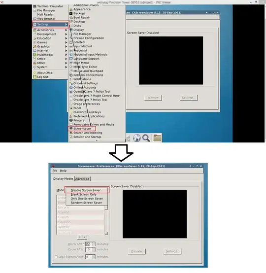

Disabling Screensaver on Linux Environment from VNC Viewer enter image description here
