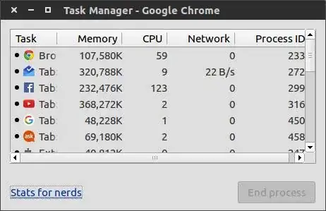

When I'm seeing any video on Chrome, my computer suddenly gets real slow, so I opened Chrome's task manager...
Task manager 1
Task manager 2
Why is this happening?

  1. Edit /etc/modprobe.d/local.conf
  2. Add the following line:
    options drm_kms_helper poll=N
  3. Restart and problems are gone (at least for me with Ubuntu 14.04 LTS).
