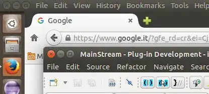

After 15.04 installation I can no longer see the title bar title when a window is maximised. It worked perfectly in 14.04 but now it's messed up.
This is how I see my eclipse not maximised:
And this is what happens when it's maximised
In 14.04 "MainStream" were visible on the title bar with maximised window. This happens also with other programs/windows.

It looks like the title bar and menu bar reside in the same space.
When your cursor is not at the title (for example,ready to select some option), the title is displayed.
nyxee
  • 367
You could reinstall the desktop via
apt-get install --reinstall ubuntu-desktop unity compizconfig-settings-manager
If that does not clear your problem, you could delete dconf via :
cd ~ ; mkdir .config/dconf.ORIG
mv .config/dconf/ .config/dconf.ORIG/
You risk losing a few personal settings like font settings, but you may return to a sane and better desktop.
