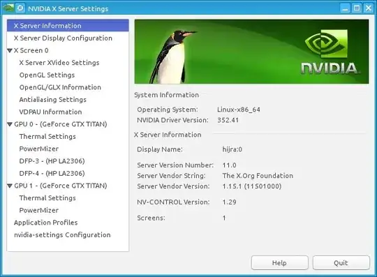

I spent a full day seeking to use "ppa:graphics-drivers/ppa" to update the NVIDIA drivers to version 352. Everything failed. After one install, the gpu-manager.log reported that the drivers were installed while Xorg.0.log would report the opposite.
The nouveau driver had been removed and blacklisted: sudo apt-get --purge remove xserver-xorg-video-nouveau cat /etc/modprobe.d/nouveau-nomodeset-jsrobin.conf blacklist nouveau options nouveau modeset=0 alias nouveau off alias lbm-nouveau off
I finally gave up and used a purely "NVIDIA...bin" solution.
  1. Blacklisted nouveau, as shown above.
  2. completely uninstalled the nouveau Xserver as cited above.
  3. Set the system bios to have PCIe (the two nvidia cards) as primary and deactivated the mainboard HD4600 interface.
  4. booted into recovery mode, activated network, then went to console mode.
  5. Ran "NVIDIA-Linux-x86_64-352.41.run -uninstall" just to make sure nothing was left.
  6. Deleted any old directories in /etc, /usr/local, that looked like a remnant of past cuda or nvidia installs.
  7. Ran "NVIDIA-Linux-x86_64-352.41.run"
  8. Ran "NVIDIA-Linux-x86_64-352.41.run --check" to verify that everything was correct (it was).
  9. Then ran "cuda_7.5.18_linux.run" to complete the install. Things are currently working. Both monitors are up and working. Currently working on building the cuda sample files. Be certain to use the "--help" flags on the NVIDIA install bins. The main reason I decided to go the bin route (along with one of the alternatives not working, is that the "bin" approach provides an easy route to recovery after a "mesa" OpenGL update. The result
