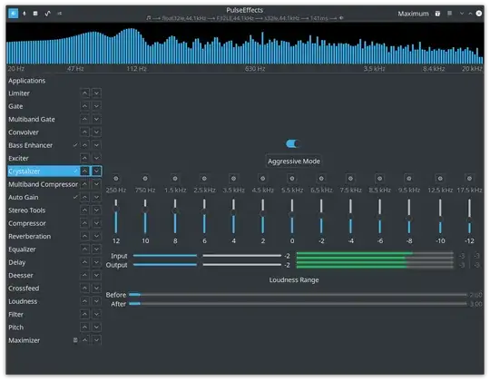

Well, if what you really need is to feel music louder, you can use pulseeffects on Ubuntu.
Install:
sudo apt install pulseeffects
Run:
pulseeffects

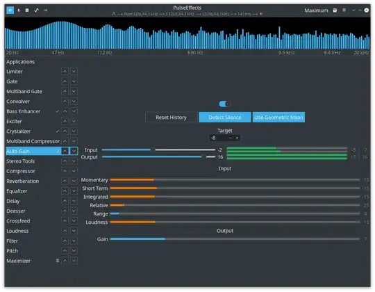

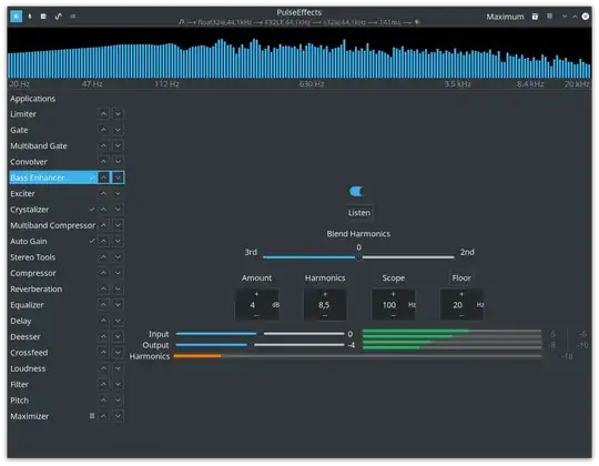

This is the configuration I've ended up myself at Kubuntu 20.04:
Base Enhancer makes bass louder.
Cryslalizer makes mid and high frequencies sound better.
Auto Gain is able to make sound louder when it is present, because it is able to detect silence.
Maximizer always makes sound to feel louder, but more importantly, it intelligently reduces volume to protect audio from clipping. So there is no artificial noise in the audio.
Be sure your audio pipeline has the same order for enabled audio effects to get the best experience.
