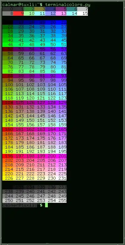

To check if it works, run this little script:

Thereafter, you will see something like the following (depends on your gnome-terminal theme):
