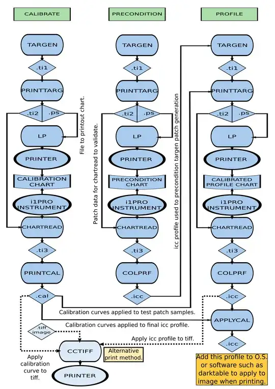

Workflow.
argyllcms printer profiling workflow

The .cal file produced in the calibration step and the .icc file produced in the preconditioning step are copied to the profile directory. I also copy the darktable version of adobeRGB from ~/.config/darktable/color/out over to the Profile directory as I export my images in compatibleWithAdobeRGB1998.icc and to work properly in all rendering intents the final profile created needs to have a source gamut. If outputting images to sRGB use that.
Calibrate
NB: In reality we can do calibrate and precondition at the same time as they are independent of each other and this saves on time waiting for the printed targets to dry.

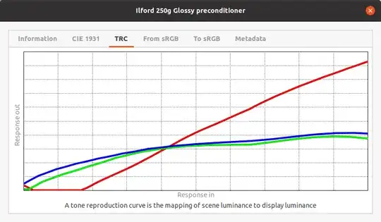

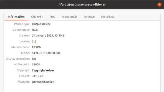

The result is a profile named precondition.icc that checks out as:
Profile check complete, peak err = 3.525718, avg err = 1.103403, RMS = 1.306283
precondition profile info precondition profile cie precondition profile trc

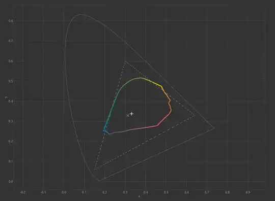

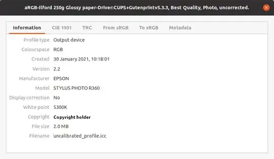

So at this point we get an uncalibrated profile (that could be used to preconditon another profile on a later day) and the message:
Profile check complete, peak err = 3.994448, avg err = 0.965683, RMS = 1.116472
uncalibrated profile info uncalibrated profile cie uncalibrated profile trc
applycal calibrate.cal uncalibrated_profile.icc epsonR360_ilford250g_calibrated_290121.icc

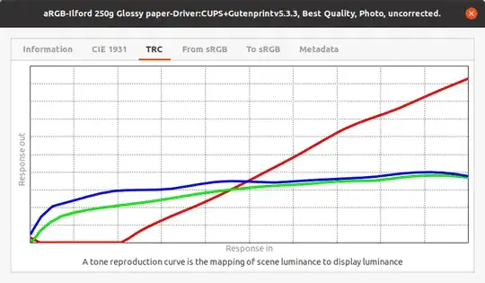

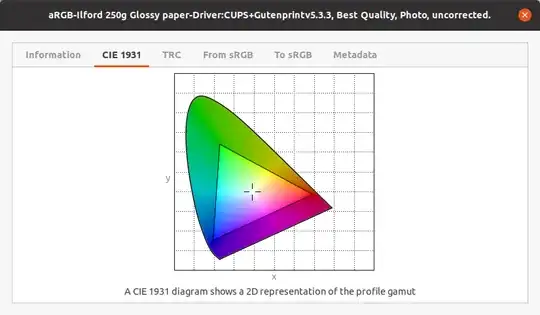

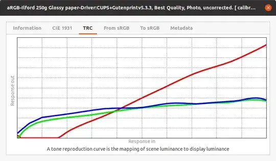

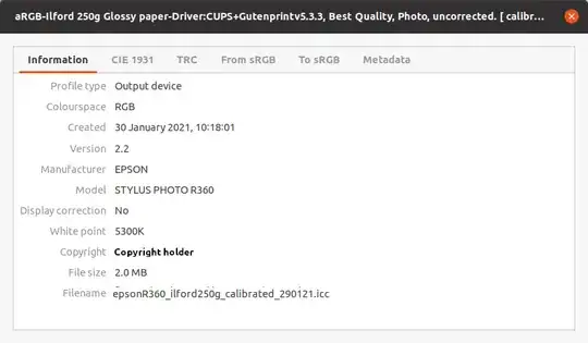

Now we have a calibrated profile that seems to have a lot of errors:
Profile check complete, errors: max. = 32.786458, avg. = 14.043563, RMS = 16.093862
calibrated profile info calibrated profile cie calibrated profile trc

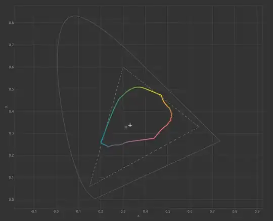

Colour experts will doubtless look at this and question the validity of the profile. Those TRC charts look odd, but as I said I am no expert. When I print with this profile in darktable it produces the best results I have managed so far on my Ubuntu Linux journey.
Some thoughts
Whilst experimenting with some Xerox 90gsm Inkjet paper I found merely pre-conditioning the second run of targen creates a tailored target that is (in my case) much lighter when printed and closer to the limits of the capabilities of printer, paper and driver.

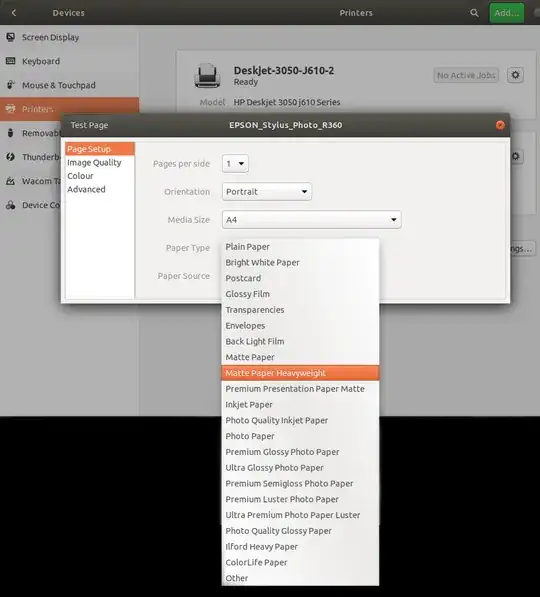

paper types drop down

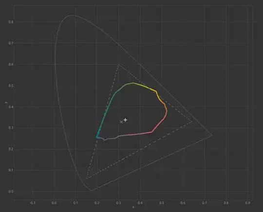

Selecting the correct paper type has a big impact on the print quality you can achieve. With the driver set to “plain paper / best quality” the print quality was comparable to the “photo quality inkjet paper / high quality setting” and the colours the same after with a profile applied. However, printing an A5 Ubuntu test page took much longer (approx 1min 30secs as opposed to 45secs). Put the settings to “photo quality inkjet paper/ best quality and the time leaps up to 2mins 30secs but the print quality is far superior as more ink is applied in more passes of the print head. When you look at the profiles (I used “ICC Profile Info from Displaycal) there is a slightly larger gamut in the profile which you can achieve with the better quality paper settings.
plain paper-best quality gamut Xerox 90gsm profiled with plain paper at best quality setting. photo quality inkjet paper-best quality gamut Xerox 90gsm profiled with photo quality inkjet paper at best quality setting. photo paper-best quality gamut Xerox 90gsm profiled with photo paper at best quality setting.
The following table is my very non-scientific interpretation of the results of different paper types on targets printed in the process of making the test profiles. It shows that you can’t keep upping the quality beyond what the paper can take. Eventually the excess ink will bleed together to make a muddy mess and the paper will buckle causing the print head to touch the paper and smear ink everywhere.
Driver paper type Speed (min) Banding Smudges Peak err Av'ge err Gamut size
#1. Plain 1 1 4 5.99 1.13 1
#2. Bright White 1 1 4 5.87 1.11 1
#3. Matte 2 3 2 5.97 0.99 3
#4. Inkjet 2 2 4 5.75 1.10 3
#5. Photo Quality Inkjet 2 3 3 6.16 1.04 2
#6. Photo 4.5 4 1 4.06 0.83 4
Banding, smudges & gamut size ranked by eye from 1 = worst to max = best. Peak and average error reported by colprof.
I chose to continue the process with Photo Quality Inkjet Paper in this case because it seemed that although there were smudges, the pre-conditioned target would be lighter and the final profile would produce much lighter colours using less ink and creating fewer problems.
