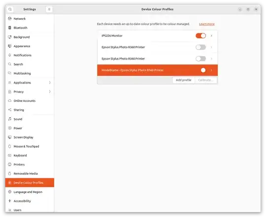

This leads to the question. If I switch to the Device Colour Profiles panel all the printers are named exactly the same, in my case Epson Stylus Photo R360 Printer. This is not helpful as different papers and printer settings require different icc calibration profiles. I believe the cups / colord system can automatically assign some profiles but I used argyl cms at the command line to create my own profiles so I don't think that will work for me.
So, rather than guesing, how do I change the names to make them unique and useful in my use case?

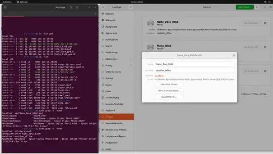

To try and find where the printer name is stored and the .ppd file named I experimented, altering the printer name in the Printers panel by clicking the cogwheel beside the printer selecting Printer Details from the dropdown and altering the Name field, then monitoring which files were altered with
ls -lat /etc/cups/ppd

Altering the name in gnome-control-center renames the /etc/cups/ppd/Name_Docs_R360.ppd filename and then cups updates the DefaultPrinter or Printer fields in /etc/cups/printers.conf. Location is set here too.
Quick back up
sudo cp /etc/cups/ppd/Docs_R360.ppd ~/Desktop/edited_Docs_R360_ppd.txt
and edit some of the .ppd file lines to try and find where those printer names are used.
sudo nano /etc/cups/ppd/Docs_R360.ppd
*ModelName:             "ModelName - Epson Stylus Photo R360"
*ShortNickName:         "ShortNickName - Epson Stylus Photo R360"
*NickName:              "NickName - Epson Stylus Photo R360 - Epson Inkjet Printer Driver (ESC/P-R) for Linux"
The relevant info can be accessed using:
sudo grep -i 'name
location' /etc/cups/Name_Docs.ppd
*PCFileName:            "ESCPR.PPD"
sudo grep -i 'name
location' /etc/cups/printers.conf
<DefaultPrinter Name_Docs_R360>
Location Location_office
MakeModel NickName - Epson Stylus Photo R360 - Epson Inkjet Printer Driver (ESC/P-R) for Linux
Now we have a printer named Docs_R360 in the Printers panel and one called ModelName - Epson Stylus Photo R360 in the Device Colour Profiles panel!
printers paneldevice colour profiles panel
