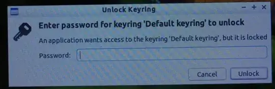

[edit] - here is the dialog box requesting the keyring unlock. enter image description here

I installed LXDE on my Ubuntu 14.04 system and started getting this keyring popup again when I took a backup. libpam-gnome-keyring was already installed on this system! To fix it, I had to add a line of text to two files, like this:
To /etc/pam.d/passwd add:
password optional pam_gnome_keyring.so
And to /etc/pam.d/login add:
session    optional     pam_gnome_keyring.so        auto_start
This will unlock the keyring on login when I log in through LXDE.
